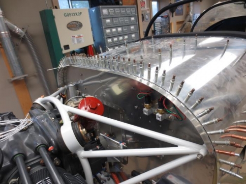

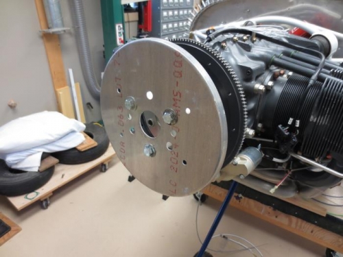

I do not plan to purchase the Hartzell propeller until the fuselage goes to the airport. In the meantime I installed 2 1/4" spacers between the propeller flange and the spinner backplate. This will allow me to set the upper cowl properly. Also test fit the upper cowl hinges.
Installed spacers
Installed spacers
Installed spinner backplate
Installing cowl hinges
