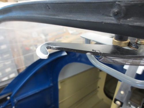

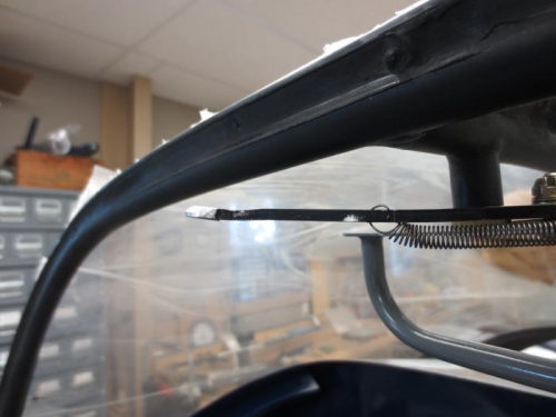

I wanted to document the slight adjustments that were made to the canopy latch. These modifications allowed it to engage the roll bar pin without any binding or interference. The end was bent slightly and the leading edge was chamfered.
Slight bend on canopy latch
Sanded down leading edge of latch
