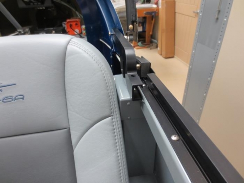

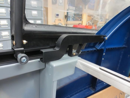

Brief Description:  Installed canopy on the supertracks
I installed the supertracks and canopy on the aircraft. The added recline of the seats is perfect. The aircraft does feel so much better. This is one of the best mods that one can do for this plane. The panel is in perfect reach and I am able to put the seal in its rear most hinge point to give me good legroom. I actually believe that I have installed the canopy for the last time. Hopefully the next time I remove it will be to paint the aircraft.
Supertracks and canopy installed

Right side supertracks
