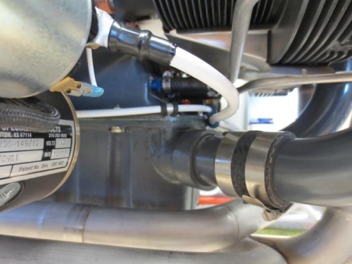

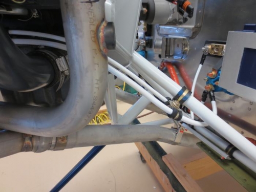

Routed alternator wiring
Routed the main alternator down the left side of the engine following the starter cable. I firesleeved the first few inches of the cable. It was about 2.5" from the exhaust manifold.
Firesleeved first part of main alternator lead
Main alternator cable routing front
Starter and main alternator to firewall
