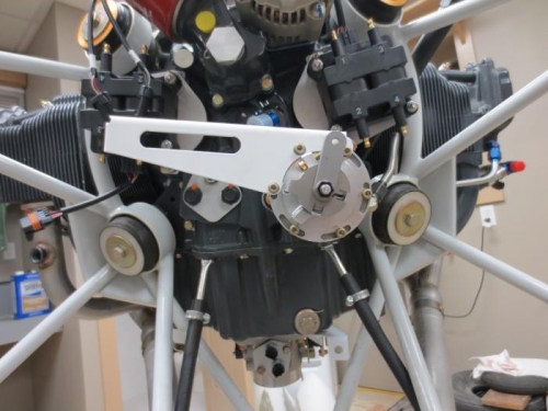

Brief Description:  Adjusted Governor
I worked on installing the prop cable. I determined that the governor back plate needed to rotated and the bracket moved one hole over. At this stage it was quicker to remove the engine frame fom the aircraft and gain easier access. I needed a good clean picture of the governor mount anyway.
Working on governor
Working on governor
Governor clocked
Governor clocked
