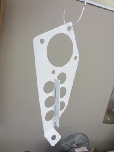

Brief Description:  Finished throttle bracket
Today I stripped the powdercoating off of the throttle bracket. Afterwards, I practiced on my TIG welding and then fabricated a strongback to go on the throttle bracket. I had to remove the bent flange by Vans to allow room for the throttle cable. Welded, primed and gave it two coats of white paint.
Welding on the brace
Throttle bracket drying
