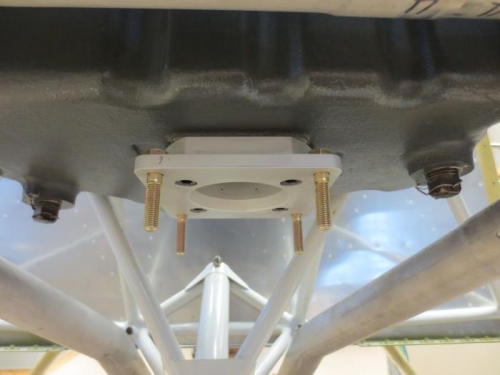

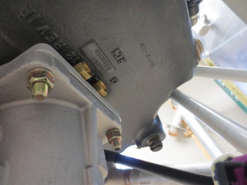

Installed the EFII throttle body today. The adaptor plate went on first. Both flanges were cleaned with laquer thinner and black gasket maker was installed. The bolts for the throttle body need to be inserted before securing the adaptor plate. Don't ask me how I know.

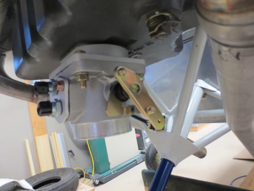

The throttle linkage had two arms on it. The arm that was not needed was cut off. It would get in the way of the throttle cable. The torque seal will be applied later this week when I get my shipment from Aircraft Spruce. My other tube dried up.
Before I mounted the adaptor plate at least I remembered to install the manifold restricters. Facing them to the rear will allow the hose to have the least amount of bends.
Adaptor plate installed
Throttle body with arm trimmed
Manifold ports
Manifold ports
