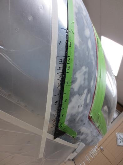

Brief Description:  Filling in copilot side canopy skirt
Today I put the canopy back on the aircraft and laid out the plans to fill in the gap. I laid up six layers of fiberglass and carbon fiber. This will not totally fill up the gap. I was leary of doing more at one time. It might have started to slump.
Started to fill in the gap
