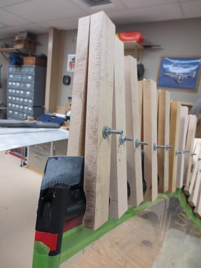

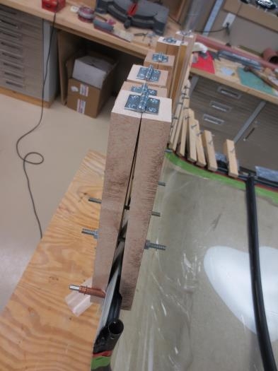

Today I removed the clamps from the copilots side and installed the skirt on the pilots side. I forgot to meantion on yesterdays post that I tinted the epoxy with black pigment in the event that any epoxy that would be visible from the inside would match that of the paint. I included a couple of clamp close up pictures. I can see the end of the canopy work in sight. I still have to install the C-792 at the top back of the canopy. I will work on that tomorrow.

Clamp end view
Clamp end view
Clamp side view
Clamp side view
