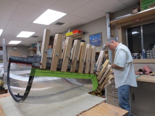

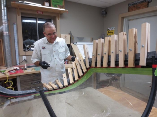

Brief Description:  Epoxying canopy skirt copilot side

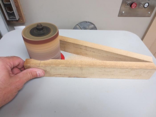

Today I built 16 clamps from hard rock maple. I needed to clamp across 5 1/2" across the back side of the canopy. I could not find suitable clamps at the store so I spent about 2 hours building them. Each consisted of 2 pieces of 12" x 1.5" x .75" wood. One end I installed a hinge. I then drilled a hole and installed a 1/4" allthread, washers and nuts. They worked out very well.
Making clamps
Making clamps
Clamps are working great
Finished clamping copilot side
