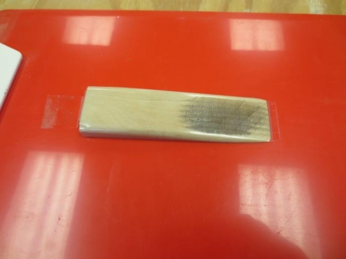

Brief Description:  Made C792
I decided to fabricate the canopy track cover C-792 from fiberglass instead of using the aluminum one in the kit. I needed it to be a little longer because my fiberglass skirt is wider than the aluminum ones in the kit. I put some black pigment in the epoxy in the event that it could be seen from inside the cockpit.
Wood mold for C-792
Wood mold for C-792
One layer of fiberglass laid up
