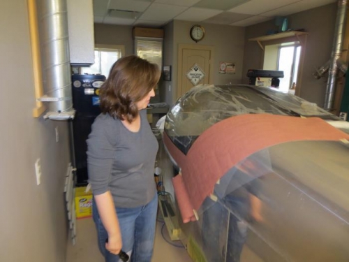

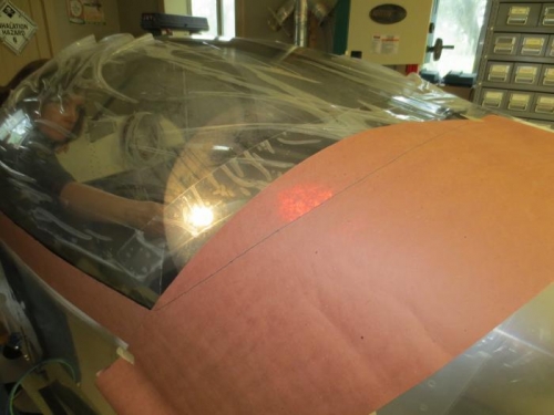

Brief Description:  Getting ready to fiberglass the canopy skirt
My wife and I are laying out some paper stock to make a template for the fiberglass. Yvonne shined a light from the inside and I traced on the outside. I used the paint line from the Sika application as my guide.
