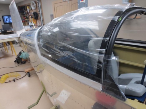

Brief Description:  Applied filler to canopy
I am going to make my canopy skirts from fiberglass. I covered the canopy and sides of aircraft with plastic tape for a release agent. I then filled the gap with microballons and epoxy. This will allow the fiberglass to have the proper support from the canopy to aircraft sides.
Applied filler left side
