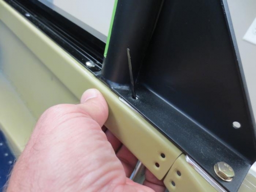

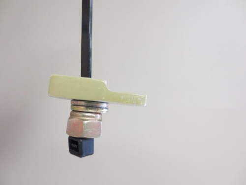

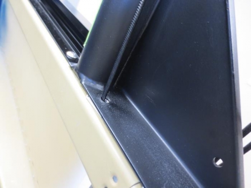

Anyone that has bolted the roll bar to the frame understands how difficult it is to get the spacer, washer and nut under the longeron ledge. I stacked all of the part on a zip tie and inserted them into the bolt hole. I then pulled most of the zip tie back out, held the parts up against the longeron with one finger, pulled out the zip tie and inserted the bolt. It made it easy.
Stacked parts on the zip tie (I reversed the nut before inserting)
Inserted the zip tie from the bottom
Pulled back down while holding parts
