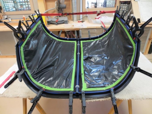

Date:  7-3-2016
Number of Hours:  3.50
Brief Description:  Applied first layer of Sika
I applied the first layer of Sika. I put a generous amount of Sika between the spacers. It is below the final layer that will be applied tomorrow. It took awhile to get everything sanded, cleaned, applied 205 activator, 209D primer and the 295 Sika. I waited 10 minutes after applying the 205 and about 25 minutes after applying the 209D.
First layer of Sika
First layer of Sika
