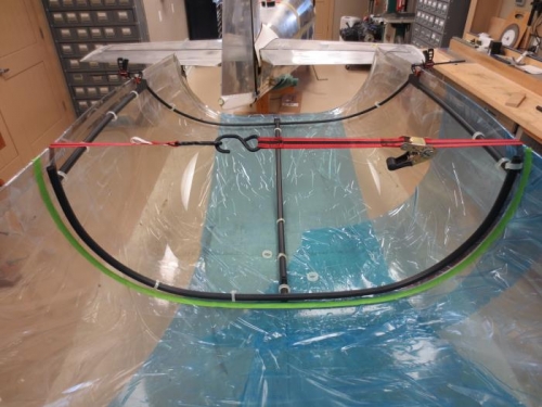

I cleaned the inside of the canopy and covered the exposed areas. I then measured and measured. Laid out the canopy centerline. I then flipped the canopy over and fit the frame to the canopy. I am going to use the Sika process to affix the canopy to the frame so I let the plexiglass overlay the lower horizontal canopy fram member. I allowed about 1" extra material at this point. I trimmed the forward edge of the plexiglass to extend 1/8" over the canopy frame.
