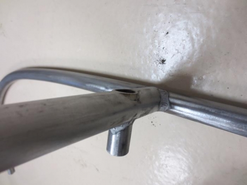

I got my new spray gun out today and sprayed some latex through it to make sure that it worked OK and I had it set up properly. I got the gun dialed in and I should be able to dial in the epoxy paint. This paint is expensive and I did not want to practice with the gun with it.
I then ground off the top of the canopy frame where the latch goes through. I have spoken to others and their tip was to grind it off, set the plexiglass and then drill the hole. Assemble with a washer made from UHMW. Makes for an easier installation.
Ground off top of canopy
