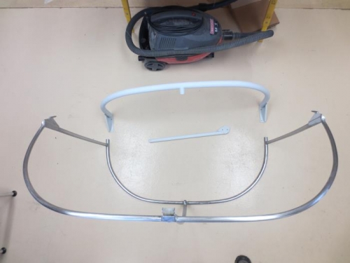

Brief Description:  Ready to paint
I have completed all of the sanding for the canopy, roll bar and forward brace. The forward brace and roll bar did not require removal of the powdercoating. There was no signs of rust underneath. I scuffed them with 150 grit. The canopy frame had rusting on the base metal. I completely removed the powdercoating with 80 grit, final sanded with 220 grit.
Work is going to be beckoning for the next couple of days. I just need to clean with laquer thinner and spray the black matte epoxy primer.
