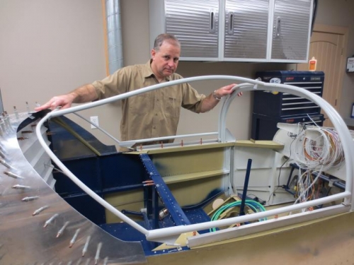

Date:  2-10-2016
Brief Description:  Fitting canopy rails
I wrestled with the canopy frame today. I set the rails to the 40 13/16" width between them. I drilled and clecoed. I massaged the canopy frame and I believe it fits just right. I will check again after I finish assembling the rear canopy slide rail. I initially set the canopy just using the C-763 spacer.
Fitting the slider frame
