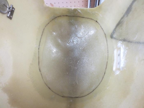

I plan to operate from grass strips and I have heard that mud and debris can collect in the rear portion of the wheel pants. Installing a partition will keep the debris from the rear portion of the pant.
I layed out the tire profile on the wheel pant, marked the wheel pant and installed one layer of fiberglass. I installed it with the pant vertical and the fiberglass made a nice cupped shape.

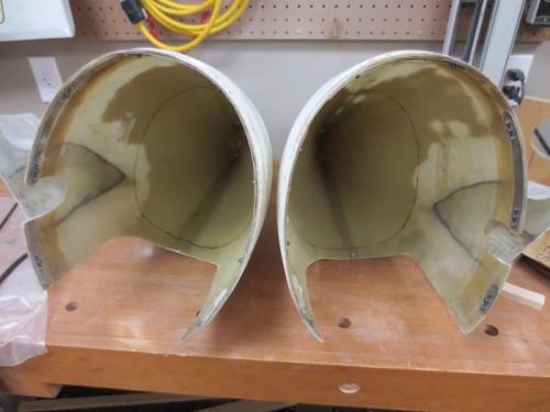

Drew line for rear partition

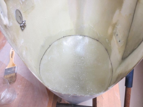

Installed rear partition
Installed rear partition 1
