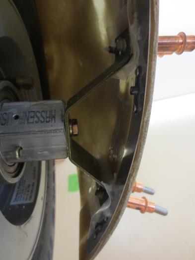

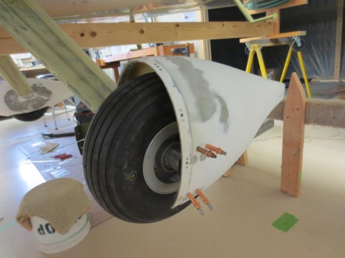

Worked on the left wheel pant today. I aligned the wheel pant so that it was parallel with the axis of the aircraft and level. I used the laser and aligned with the nutplate and installed the wheel pant. I marked the laser on the wheel pant. Drilled the hole, repeat, repeat. I then mixed up an epoxy and cotton flox batch and bedded in the six holes on the rear half of the wheel pant.
Left wheel pant fitted up
Brackets bedded in
Brackets bedded in
