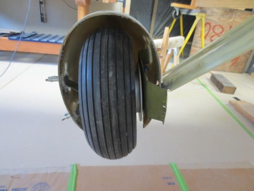

Brief Description:  Bedding in the rear of the wheel pant
I laid two layers of fiberglass where the bolts are bracket to the wheel pant. I then put a bed of fiberglass and cotton flox. I oiled up some Clecos and fastened the wheel pant to the brackets.
Right fairing with bracket bedded
Right fairing with all rear brackets bedded
