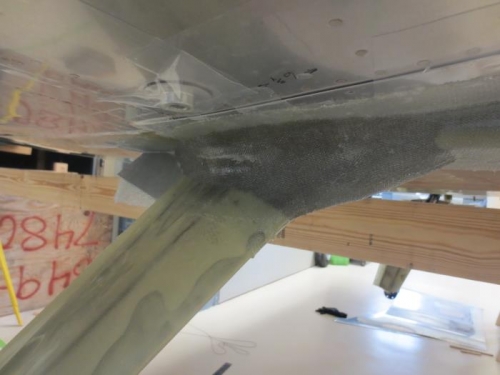

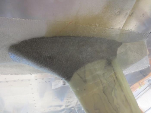

Right upper gear leg fairing
I put tape over the bottom of the wing, fuselage and leg to act as a release agent. I molded clay for the fiberglass layup. I put two layers of fiberglass on. I will put another after it cures.
