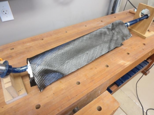

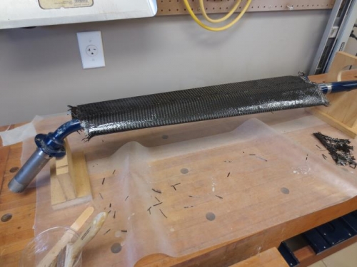

Brief Description:  Laid carbon fiber on left gear leg
I cut a sheet of carbon fiber large enough to wrap around the foam core and wrap around each of the trailing edge about 2". I wetted down the foam with straight epoxy and then laid the carbon fiber over the foam and wetting it in with a 2" brush. Feels like a productive day.
Carbon fiber cut and ready for expoxy

Epoxy curing on carbon fiber
