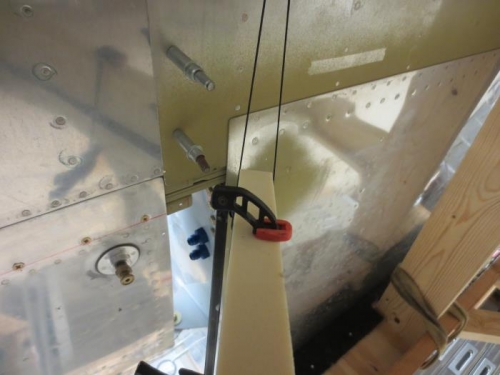

Brief Description:  Epoxied foam on left gear leg
I applied the foam on the left gear leg. I laid out parallel strings from the gear leg back to a line that I scribed on a board under the horizontal stabilizer. I used these two strings to align the foam blocks to the airstream on the aircraft. The left side did go alot easier that the right. Practice makes perfect.
Gear before foam addition, Note string at top and bottom
Lining up the trailing edge of the foam core
Left gear leg all clamped up
