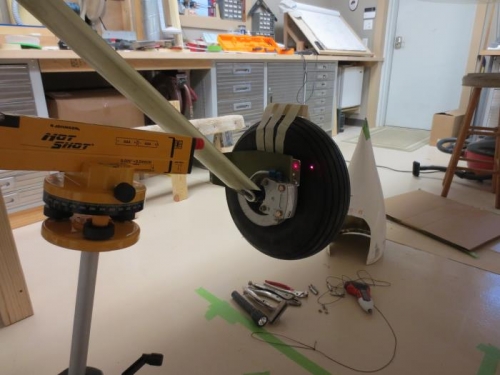

Brief Description:  Drilling holes on right wheel pant
First I had to transfer the holes on the outboard side of the wheel pant. I used the tool that is used to transfer hole between two sheets of aluminum. That side was easy. The back two holes was more challenging. I used laser on to align on the nutplate, install wheel pant, mark hole and drill. To get the laser square with the nutplate I used a square and laid it against the aluminum the the nut plate was attached and used a digital level to record the angle. I then set the digital level on the laser to set its level. Worked pretty well.

Aligning laser on bolt hole
Laser mark on wheel pant
