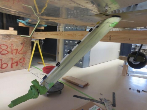

Brief Description:  Right fiberglass gear fairing installed

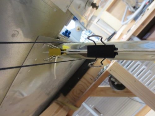

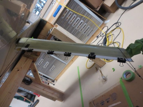

I epoxied on the right fiberglass gear fairing over my carbon fiber layup. I mixed the epoxy with microballons for a filler. I wetted the inside of the fairing and the outside of the gear leg and installed the fiberglass fairing. I ran two strings around the fairing back to the rear hooks that I installed in the previous step. I twisted the fairing so that the trailing edges (top and bottom) was in the middle of the strings. This assured that the fairing is inline with the aircraft. I used metal clips to hold the trailing edge together. When I do the left side I will not use the fast setting epoxy. This takes longer that one would think. Had to work fast.
Front view of right gear leg
Trailing edge between the strings
Rear view of right gear leg
