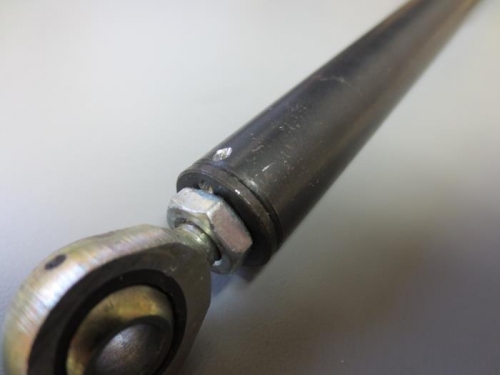

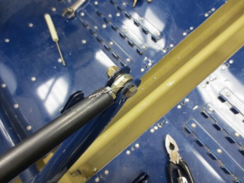

I drilled the hole in the flap motor for the safety wire to comply with Service Bulletin that Van's put out on 4-11-07.
Installed and safety wired.

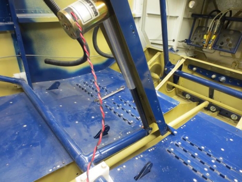

Have to wait on the push rod from Tower Hobbies to come in so that I can install the Ray Allen sensor to give flap position information to the Dynon system.
