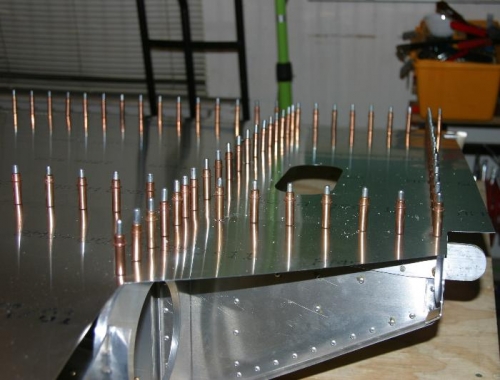

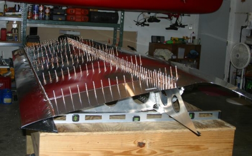

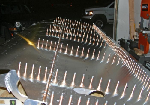

Brief Description:  Wing work continues
Continued drilling main and trailing edge spar rivet line through pilot holes in skins from the center of the wing progressing outward. Drilled holes out to the #30 final size and clecoed every hole to insure no wrinkles were in the bottom skin. Total construction now at 277 hours.
