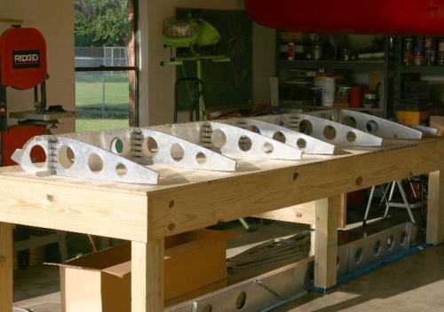

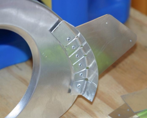

Began work on left wing. Nose rib ā€˜Lā€™ angle flanges were fitted and riveted to the four nose ribs and slat brackets. The center and nose ribs were clecoed to the spar, drilled to final size and re-clecoed to the spar. The root rib was fitted and clecoed in place. Total construction time now at 263 hours.
