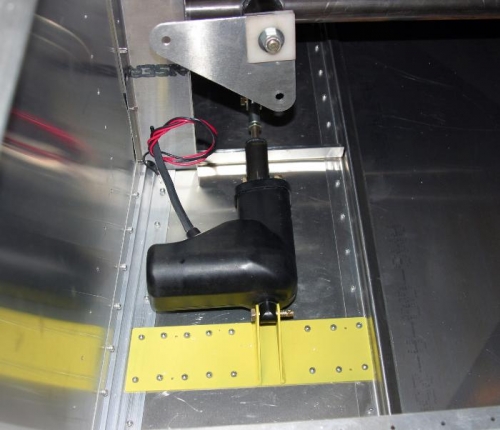

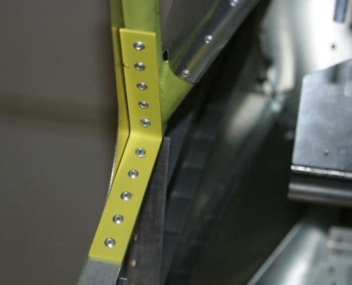

Finished misalignment problem with flaperon actuator. A 12mm extension was welded to the outboard end of the actuator bracket. The bracket was primed and installed. The top forward fuselage doublers were riveted in place. The cabin frame to forward door opening bracket was primed and riveted in place.
