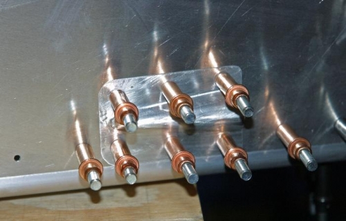

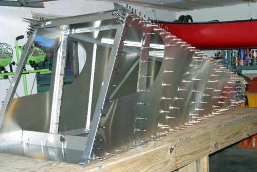

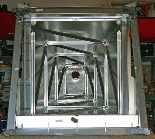

Removed both aft fuselage sides, deburred all holes in skin and ā€œLā€ angles. Clecoed both sides to bottom skin. Deburred holes in both aft bulkheads and clecoed to fuselage bottom and side skins. Shaped and fit both rudder cable exit fairlead and exit fairing to aft fuselage sides and clecoed in place. Reinstalled fuselage top skin and clecoed in place. Aft fuselage is now ready to rivet. Total construction time now at 105 hours.
