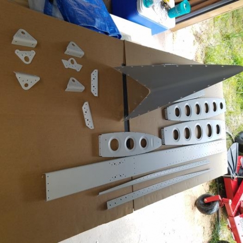

Cleaned vertical stabilizer parts to remove any grease or oily residues.
Etched parts using Stewart systems ekoetch and red scotchbrite pads.
Allowed parts to air dry.
Primed parts. Not the best job. Learning to use a spray gun at the same time. Layed the primer on too thick and it has some runs. Lesson learned.
Vertical stabilizer parts
