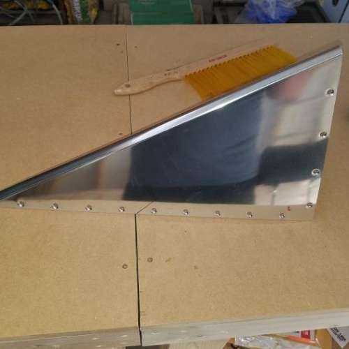

Deburred rear spar and upper and lower spar caps.
Final drilled and countersunk holes required on front and rear spar.
Used fluting pliers to straighten ribs of vertical stabilizer.
Formed radiuses on specified places on ribs as called out in plans.

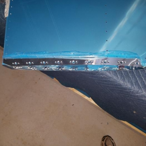

Final drilled, deburred, and dimpled nutplate holes on foward and main vertical stabilizer skin.
Forward vertical stablizer skin
Dimpled nutplate holes of main skin
