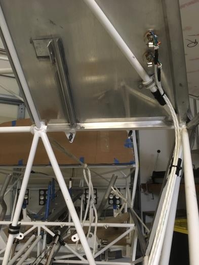

Headset jacks/wiring
Soldered the wires to the microphone and headset jacks, then started routing the wires toward the front of the panel. I made sleeves out of plastic tubing to put everywhere the wire is strapped to the metal fuselage
