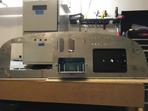

Brief Description:  Instrument panel

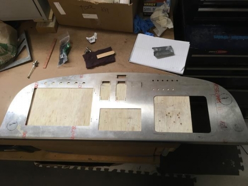

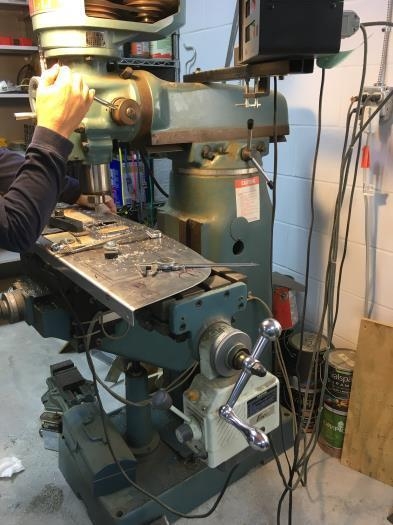

Took my instrument panel to my friend Phils house. Phil has a lot more toys than I have and one of them is a milling machine that he was willing to help me cut my panel out with. It came out really well and much better than doing it by hand especially where the edges show up such as on the Ipad mini flush mount. I still have a few things to work on but the major portion is done. Bassically a 10" Dynon HDX on the left with a Ipad mini on the right. In the middle on the low side is a glove box I bought from Vans Aircraft. Just above the box will be a Dynon remote intercom and a remote comm radio.The two rows of holes on the upper right are main buss fuses on the top row and avioncs bus fuses on the bottom. On both upper ends are vents that I purchased from Kitfox. The holes above the HDX will be swithches for lights, fuel pump, etc.On the bottom left will be the starter and just above that the master switch and the avionics master. The top rectangular hole in the center is for the ELT remote.
