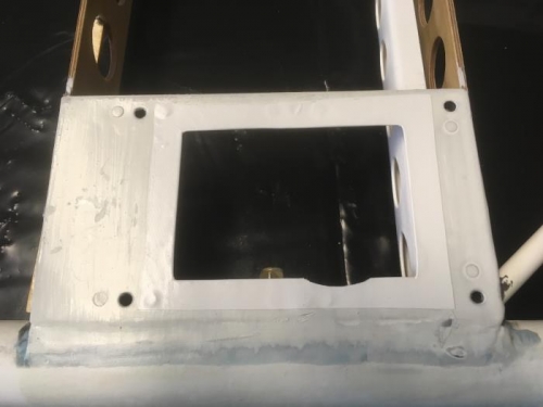

Brief Description:  Oratex
Installed small pieces of Oratex around the back plates, that the access covers attach to, for where the stabilizer struts mount. I did this since it is a sharp edge that the Oratex will be stretched around. Applied one coat of glue to the horizontal stabilizer and a second coat to all four peces of Oratex covering
Lined rough edge with small piece of Oratex
