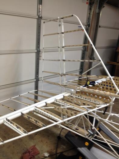

Brief Description:  Ribs installed
Installed rib stiffners on verticle stabilizer ribs. Trimmed and installed the ribs in rudder. I tried using quick set glue to temporarily install the ribs as well as trying just Hysoling them in place. It is definetly a lot better to temporarily glue everything in place with quick set glue and then Hysol everything once your happy with the placement.
