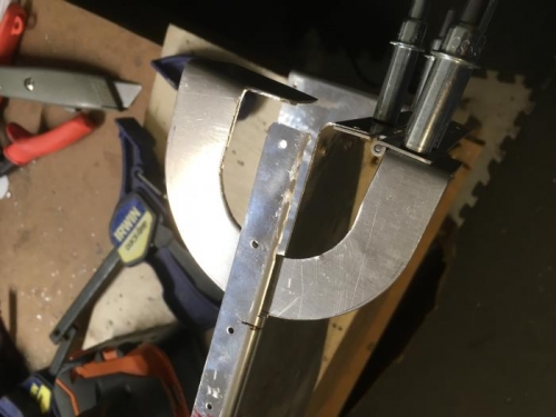

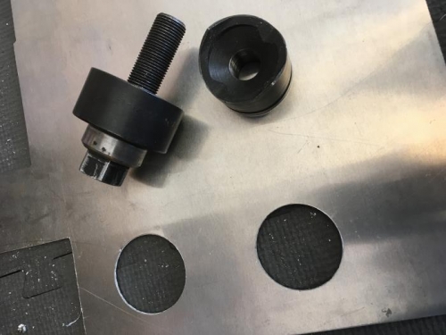

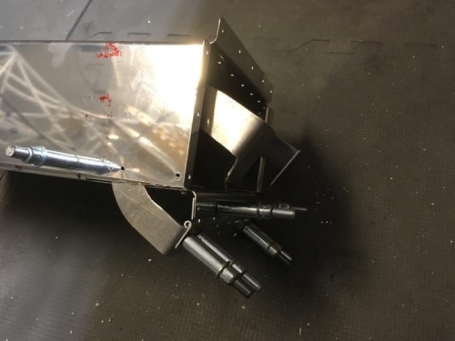

Well it was a comedy of errors but the glove box with hidden hinges is about complete. I made the hinges out of flat 2024. I used electrical knockout set to cut the inside holes and just used trial and error until I got it to work. I then bent the ends so they could be attached to the door and the hinge underneath. Since my glovebox was so low on the panel ai had to trim the hinge under the panel to get it to fit. I then installed the two stiffiner angles that go behind the panel along with the glove box.
