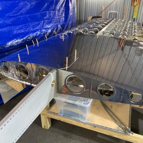

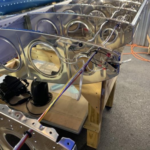

Brief Description:  Stall warner, AOA and wing skin
Completed installation of the stall warner switch. Ran wiring for stall warner, landing light and position lights. Mounted electrical connector on base rib. Initial fitting of inboard lower wing skin and wing skin doubler. Will need to reroute AOA tubing so wing attachment is at the top (not bottom) of the rib.
