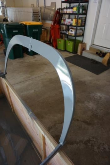

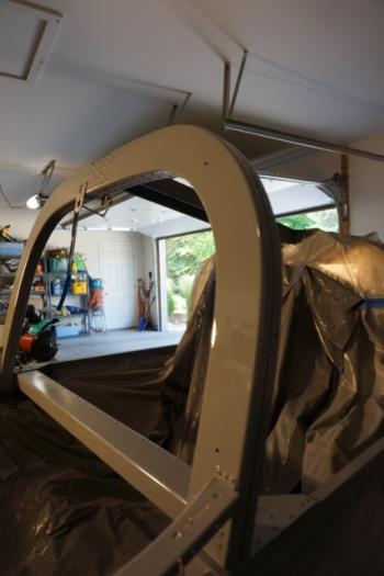

After reassessing paint today, decided several areas needed to be redone to achieve an acceptable surface. Areas were sanded to promote paint adherance, cleaned and masked. A second coat of enamel was applied, with special attention to spray technique. Cans were held closer to surface and after a tac coat was applied, a heavier wet coat was sprayed. Results appear to be much improved.
