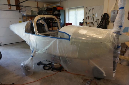

Brief Description:  Prepping interior for paint

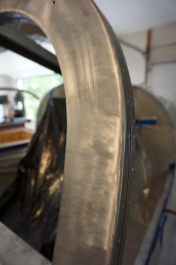

Preparation for painting continues. Fuselage maksed to prevent overspray from gertting on outside skins and protect instrument panel. All metal sanded with scotchbrite pads and oils removed with degreaser and mineral spirits. Once satisfied with prep, sprayed acid etching primer. Rattle cans take some getting used to!
Masking for overspray
Metal prep
Metal prep
