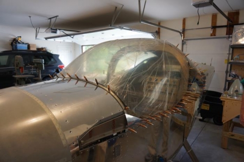

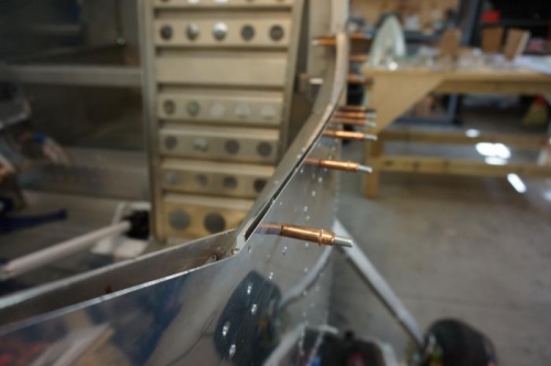

Final fitting of canopy and skirts. Slight bend of frame to align with fuselage, filing welds to ensure they do not interfere with closure. Added alignment blocks and guide plates. Fabricated canopy handles from 3/4 inch angle. Began prep for painting interior.
Final alignment of frame
Fits!
Fits!
