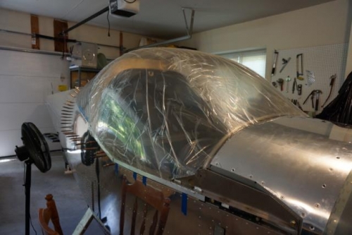

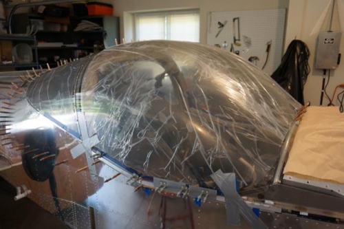

Trimmed canopy for final fit to frame. Minimal material removerd from sides. Installed temporary fasteners on cowl sides to prevent bulging while front and rear were drilled and clecoed. Beginning at center, and sequencing back and forth, front/rear, left/right, drilled and clecoed canopy. Finally, added skirts.
Final trimming of canopy
Temporary fasteners on canopoy sides
Skirt
Skirt
