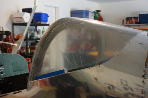

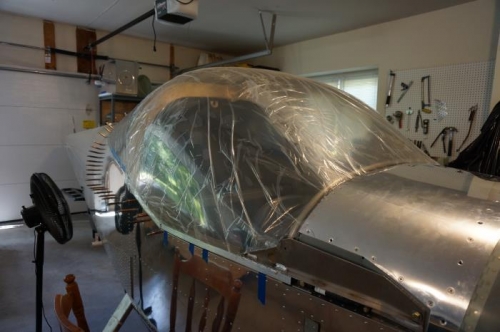

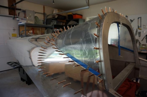

Minor trimming of rear window required. Marked location for screws in rollbar and drilled starter hole in plexiglass, Removed, completed holes and replaced on plane. Drilled corresponding holes in roll bar. Removed window, deburred and tapped all holes in rollbar for 6-32 screws. Reinstalled with temporary fasteners. Placed canopy on frame for initial fitting
Drilling
Drilling
Final fit
Final fit
