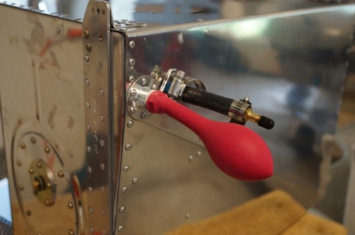

Pressure tested fuel tank
Purchased enough balloons for 12 RV12's and pressure tested the fuel tank. Maintained pressure for >8 hours. Any leak likely to be very small.
Balloon inflation test
