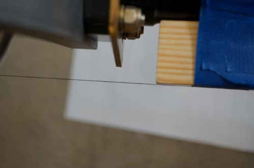

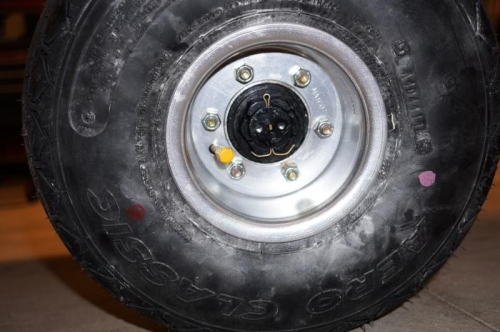

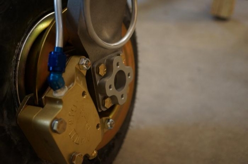

Hoisted plane and removed both main wheels. Rechecked axle alignment. Could not replicate the toe-in identified on previous check, so did not insert shim. Added additional hardware for wheel fairings and remounted wheels. Axle bolts tightened per Matco instructions and cotter pins inserted.
Checking axle alignment

Wheel fairing hardware

Cotter pins inserted
