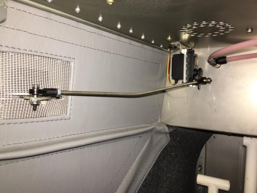

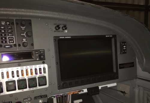

Vent controls
Electirc vent controls added. Built using 2 R/C servos driving vent covers. Servo control board and voltage converter (12v to 6v) installed in avionics bay. Servos activated via left and right 5k potentiometers mounted in panel.
