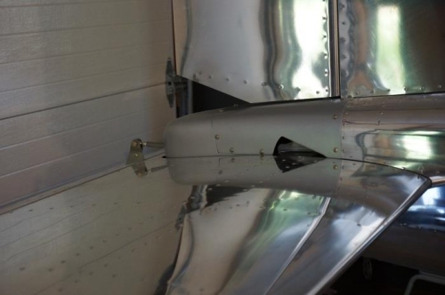

Final finished tailcone fairing, checked all control limnkages and rudder/stabilator fasteners, and attached fairing.

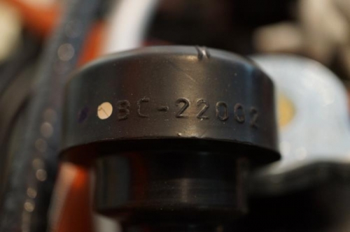

A recent service bulletin from Vans noted that incorrect engine isolators had been sent to some builders over the past year. I was unable to see the markings on my isolators as they were hidden by the engine mount, air filter, and multiple oil and water lines. the upper engine mounts were removed while holding the engine with a hoist. Both were found to be correct, and reinstalled.
