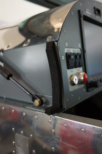

Brief Description:  Canopy seal
Added seal kit components per instructions. Seal placed under front canopy fairing lifted fairing off forward fuselage and place stress on fairing/canopy joint. Whe initially formed, a minimal gap (~1/64 inch max) was created between the fairing and fuselage. The molded seal will not fit in this gap. Fairimng removed and will comsider either alternative placement, or using earlier gap seal instructions which described using a bead of silicone.
Side panel foam
Side panel foam

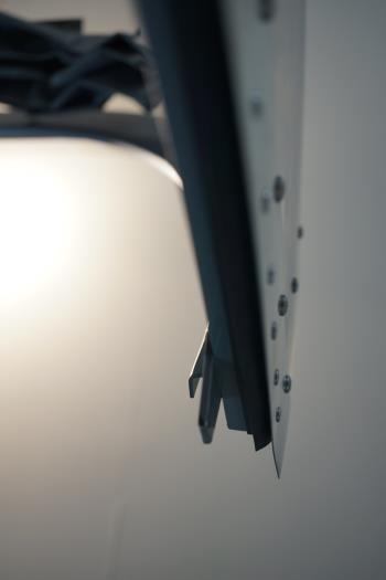

Canopy base seal
Canopy base seal
Canopy rollbar seal
Canopy rollbar seal
